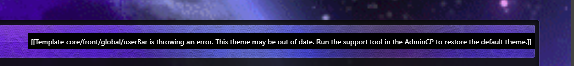

Genesis 3DX Posted June 20, 2021 Posted June 20, 2021 ok so i updated them and now i get error message ughs please help
picasso Posted June 20, 2021 Posted June 20, 2021 6 hours ago, Genesis 3DX said: ok so i updated them and now i get error message ughs please help Warning from the first post: On 6/15/2021 at 5:27 AM, Ehren said: Note: This 4.6 theme update should only be used with Invision Community 4.6. It is not compatible with Invision Community 4.5.x. You should upgrade your software first before upgrading your theme.
Ehren Posted June 20, 2021 Author Posted June 20, 2021 9 hours ago, Genesis 3DX said: ok so i updated them and now i get error message ughs please help Hello, Your site is still using Invision Community 4.5.4.2. You'll need to upgrade your software to 4.6 if you want to use the 4.6 theme. 1
Genesis 3DX Posted June 20, 2021 Posted June 20, 2021 im afraid if i upgrade to 4.6 my plugins i spens hundreds of dollars on wont work
picasso Posted June 20, 2021 Posted June 20, 2021 1 minute ago, Genesis 3DX said: im afraid if i upgrade to 4.6 my plugins i spens hundreds of dollars on wont work Then to solve the template error you need to reinstall your older theme matching your current forum installation.
Genesis 3DX Posted June 20, 2021 Posted June 20, 2021 2 minutes ago, picasso said: Then to solve the template error you need to reinstall your older theme matching your current forum installation. how do i do that since i installed from ACP panle marketplace and updated from there . There is no download
picasso Posted June 20, 2021 Posted June 20, 2021 I don't know which theme you are using, but you can open the Marketplace site directly in your browser, find the theme in Downloads and check if older version is available. If not available then for sure Ehren will help you to download the theme from this site.
Genesis 3DX Posted June 20, 2021 Posted June 20, 2021 1 minute ago, picasso said: I don't know which theme you are using, but you can open the Marketplace site directly in your browser, find the theme in Downloads and check if older version is available. If not available then for sure Ehren will help you to download the theme from this site. Thank you im using Titan.. i will check there.

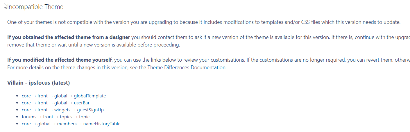

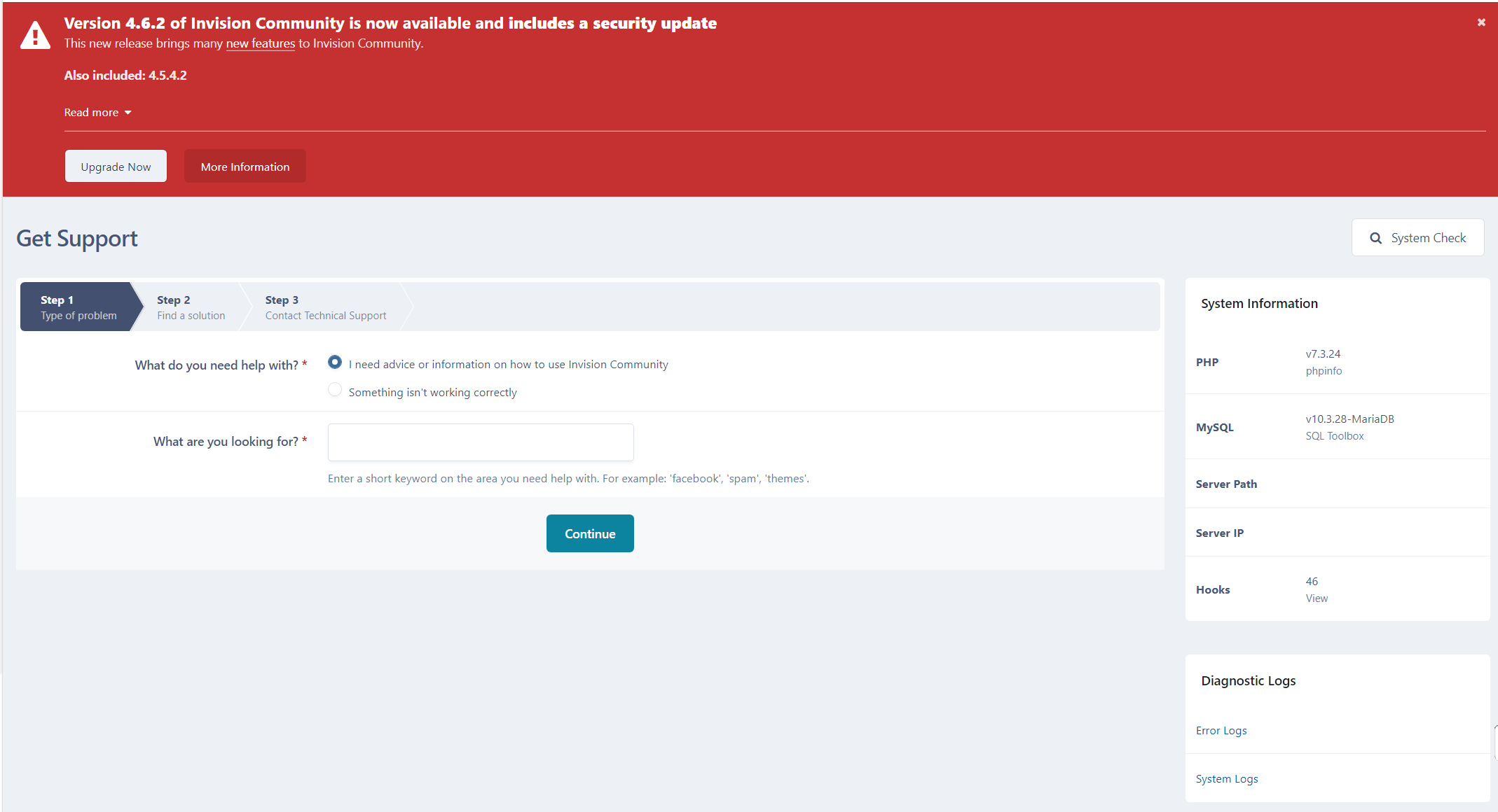

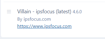

PCToolbin Posted June 25, 2021 Posted June 25, 2021 I recently upgraded the modified Villain theme I purchased in March: My Invision version currently is: I logged in today to send an email but noticed an upgrade was needed -- so I try and upgrade to the newest Invision 4.6.2 and I get the following error: I am unsure what to do at this point - what files should I backup with my theme so that I can restore if I am told to do a fresh theme install? Can I simply disable the theme (using the IPS default theme, upgrade and then reenable the theme? Thank you in advance for your time!
picasso Posted June 26, 2021 Posted June 26, 2021 29 minutes ago, PCToolbin said: Can I simply disable the theme (using the IPS default theme, upgrade and then reenable the theme? Yes, just try this simple step first. After upgrade run also Support Tool to clear caches. 1
PCToolbin Posted June 26, 2021 Posted June 26, 2021 46 minutes ago, picasso said: Yes, just try this simple step first. After upgrade run also Support Tool to clear caches. Where is that support tool? In my admin control panel, I go to "Support" and there are no tools there, only a way to ask a question and maybe submit it to tech support. UPDATE: This is pre-upgrade - just re-read your comment and you said to do this after upgrading to 4.6.2 - I assume this support area will appear different once it's upgraded?
picasso Posted June 26, 2021 Posted June 26, 2021 13 minutes ago, PCToolbin said: Where is that support tool? In my admin control panel, I go to "Support" and there are no tools there, only a way to ask a question and maybe submit it to tech support. You are on the right screen. Select "Something isn't working correctly" and the tool will automatically clear caches. 1
Ehren Posted June 26, 2021 Author Posted June 26, 2021 3 hours ago, PCToolbin said: I recently upgraded the modified Villain theme I purchased in March: My Invision version currently is: I logged in today to send an email but noticed an upgrade was needed -- so I try and upgrade to the newest Invision 4.6.2 and I get the following error: I am unsure what to do at this point - what files should I backup with my theme so that I can restore if I am told to do a fresh theme install? Can I simply disable the theme (using the IPS default theme, upgrade and then reenable the theme? Thank you in advance for your time! Hello, Technically you should upgrade your software first, followed by the theme. Using the 4.6.x Villain theme on a 4.5.4.2 forum will result in errors. A general rule to follow is to make sure your theme and software versions are the same (ie. Villain 4.6 and Invision Community 4.6). The warning message you're getting is to simply let you know that you have some modified template files. With that said, the topic, nameHistoryTable and guestSignUp template files shouldn't be modified unless you've modified them yourself. You can either revert those files, or install a fresh version of Villain 4.6 to ensure you're using an updated version
